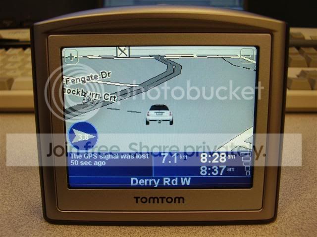

I read the entire post and felt the topic deviated a little bit. However if you still want to change the car icon in Navcore 7 "lite". There is a piece of software called Tomtom Xplorer available for free at www.tomtomheaven.com. I tried it an worked fine on my Go 300 with Navcore 7.162.
The only difficult part is that the website is in french and so is the software.
If anybody needs it I can give setp by step instructions.

Thanks! It worked for me as well on my One 3rd Edition w/Navcore 7.162.

*** AS ALWAYS BACK UP YOUR DEVICE BEFORE ATTEMPTING ANYTHING BELOW ***
Download the software from the link below
http://www.tomtomheaven.com/data/zip/tthxplrr.zip
Unzip it and run the setup.exe file.
You will find a new group entry in the start menu, named TomTomHeaven and inside it TomTomHeavenXplorer
***Before running the program I recommend:
? backup your settings.dat (eg settings.dat.old) in your tomtom to your computer;
? create a new folder named art and within it another folder named cars;
? put in there any cursor you want to use (.bmp file 80?80px)... You can download a lot of them from TomTomHeaven using the link under the cursor picture.
Then
? start the program TomTomHeavenXplorer;
? click Backup (Sauver in french) so you'll get another backup of your setings.dat which you can restore using the Repare (or R?parer in french) button;
? choose your curseur in the file list which shows you the content of your art/cars folder;
? click Apply (Appliquer in french)
- Disconnect tomtom and restart it.
