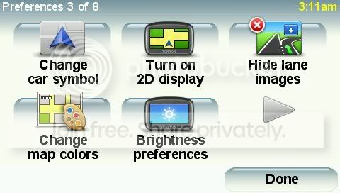

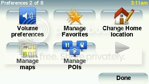

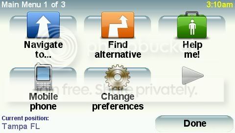

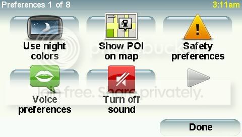

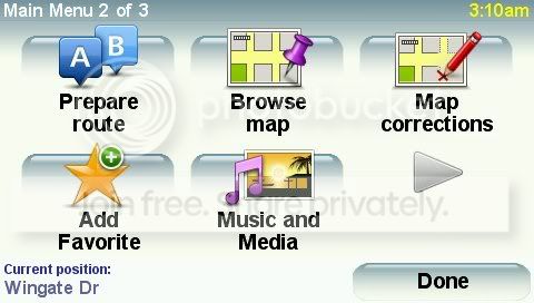

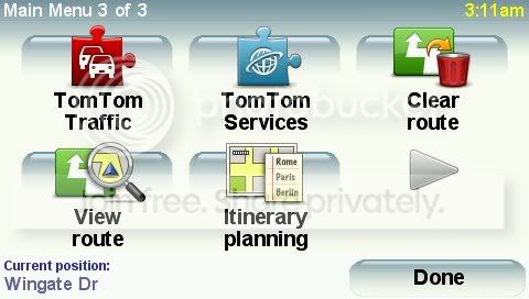

I ended up just installing NavCore 8.203 which is meant for the x40 units. I'll use this version for now since it's running beautifully until. I'll go back to the proper version once TomTom fixes their software.
My refresh rate is amazing compared to 8.3. One thing that really caught me off guard is the fact that ALL of the icons in the OS changed. I don't know whether I like them or not but I guess I just have to get used to them since I'm used to speeding through the menus by just looking at the icons.
The drawback with using this OS version is that you lose the ability to use PLUS services, but for me that's not a problem because I don't use these services anyways. I don't have a phone that the TomTom supports. I know this is nothing new to many of you, but just thought I'd share my experience.
Here's a few screenshots for those who have never seen some of the icons.
