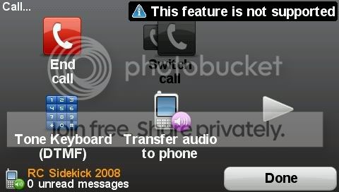

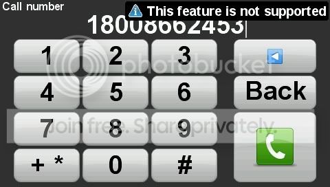

I haven't used Bluetooth for about 3 versions now but decided to try it out on my cell phone right now and was shocked to see that the TomTom is STILL paired with my Sidekick 2008 after all this time. I attempted to make a phone call to T-Mobile customer service and it went through perfectly. There is one problem though that didn't exist before. I can no longer use my TomTom to enter in numbers once the call has started. When I try to bring up the touchpad I get the message "Not supported." I needed to press the number "2" so t-mobile could direct me as a "current customer" The only way I could continue the call is if I hit the number 2 from the cell phone itself. :(
Blah you jinxed me! Now that I tried making calls an hour later, everything is giving me messages that it's not supported.
Edit: It now works again after re-pairing the phone but I still get the "not supported" when attempting to use the keypad once I'm in a call.
