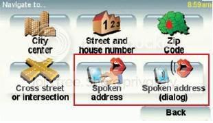

To use Voice recognition click on the main menu and select 'Navigate to'
Then select 'Address'

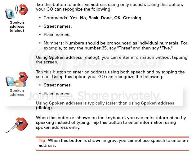

You will see 2 Voice Recognition options.
The difference is that the Spoken Address(Dialog) will ask you to state city, address, etc while the other option will not verbally ask you these options.
The next page will take you to this:

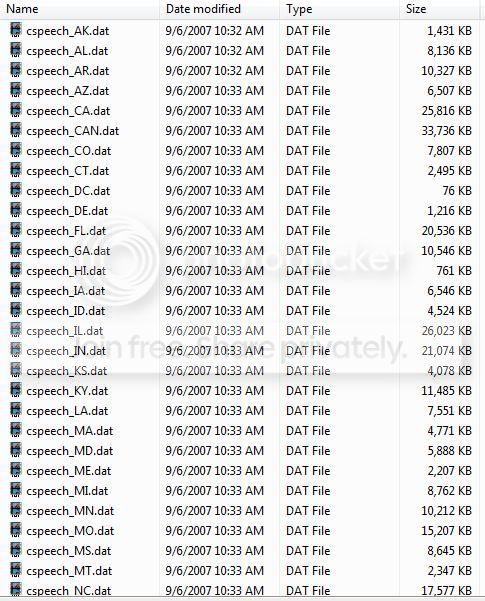

ok then all i do is copy my speech files to my pc
And the support ASR
then upgrade my firmware to 8.10
then upgrade my maps to 8x
Then copy the speech files to NorthAmerica folder
and support ASR to ASR folder
And this will work, anyone tried this I dont want to lose Voice Recog if I do this

The firmware is 8.010. Your upgraded 8x map should already have the csspeech.dat files but it is a great idea having the backup, just in case. If VR doesn't work with the map update 'out of the box', then indeed see if the support_asr.dat file is in the asr folder and, if not, copy it from your backup.
