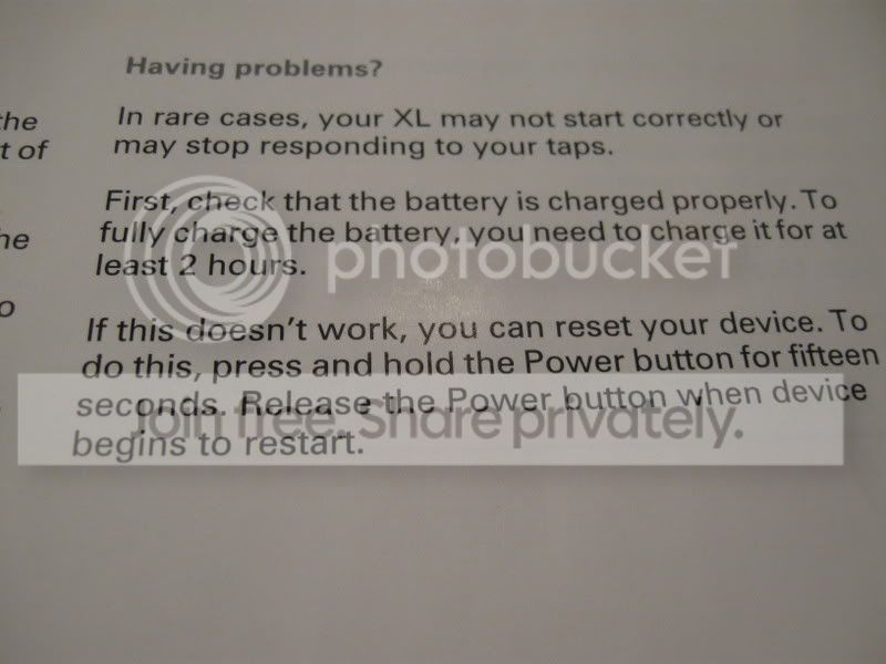

Note - there should be a small pin sized hole under there - did you find it and use it? I am used to the 7xx- 9xx series, and the newer ones are clearly laid out. Your user manual should mention it (if that is what i am seeing in the picture).
PS - did you do the backup?
No pin hole, Guess you have to push and hold the power button for 15 sec..Which didn't help me at all..
No matter what I do I can't get the update to work..So, Guess I get no updates..:(

It says hold down for 15 seconds or until the unit restarts.
Anyway, glad GAW got you up and running again.
Isn't that the reset hole just to the right of the USB port in your photo? It's kind of oval shaped.
Tried it before I even made this thread, It's a light...I still tried the stick a toothpick in there, It's just a light..
