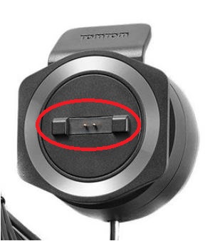

It's the two locking tabs that are stuck,
so I think you'll have to force the top lever to release them.

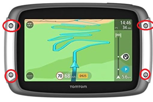

I don't know if it might help to remove the screws and see if that unblocks the GPS.
maybe try sliding a thin brass shim down in between the back of the Rider and the mount to work it free? (Disconnect power first)
It's going to have to be extremely thin.
