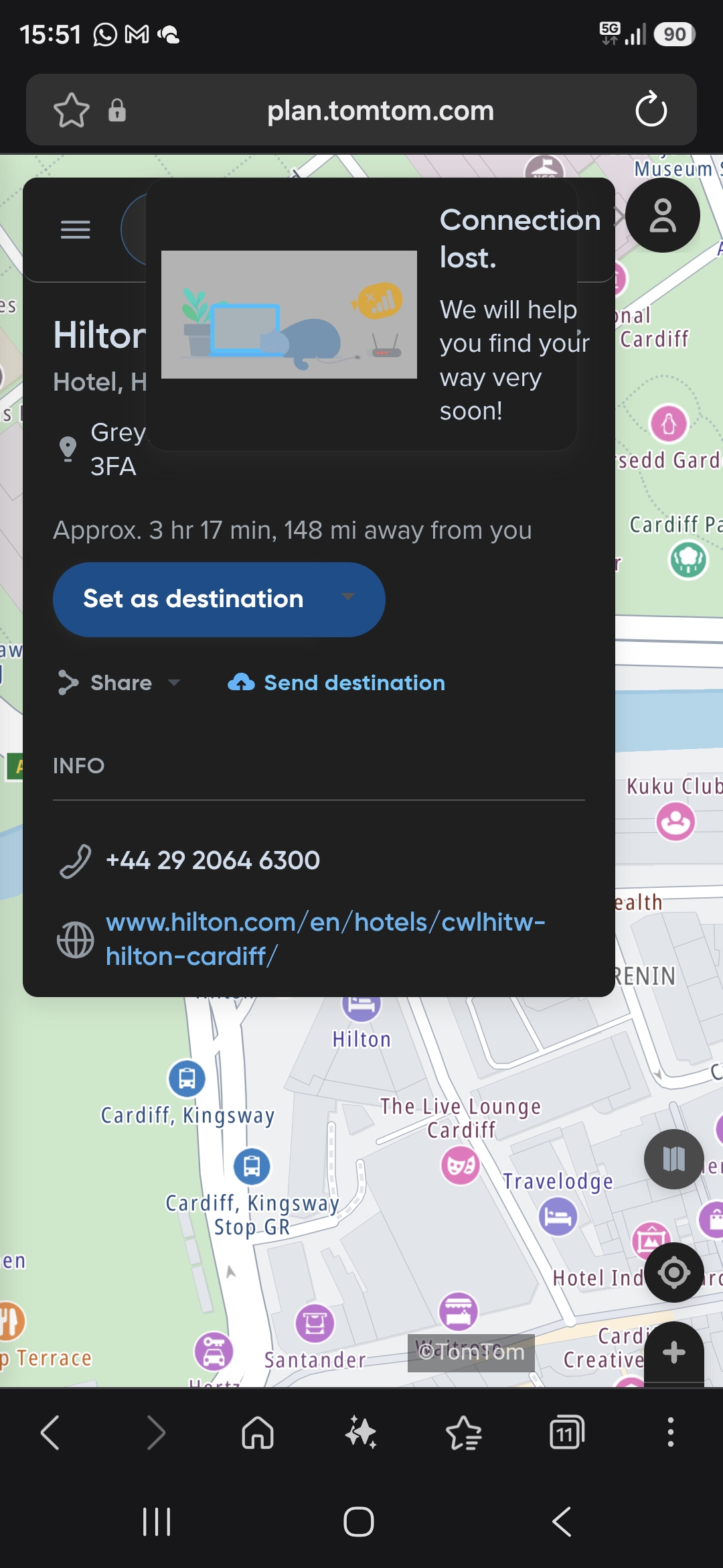

So getting at my witts end and need help. So I have a tomtom 6250 pro. Had to reset it and log back into everything. Now the app is playing up saying there is an error. Logged out and back in again and just getting connection error all the time can anyone help please

Its not the nav its the phone version to ping it over to my nav. Its saying connection lost all the time

App shows as connected to device. The app has permissions accepted yet its still doing the same. Its been deleted and re added 3 times still doing the same

Since the app shows as connected and permissions are fine, but you are still getting the connection error after three reinstalls, the next thing to try is clearing out the pairing completely and starting fresh from scratch - not just reinstalling the app, but removing the device from your phone's Bluetooth list entirely.
Here is the sequence worth trying:
Full reset of the connection:
1. On the phone, go into Bluetooth settings and forget/unpair the 6250 Pro completely
2. On the 6250 Pro itself, go to Settings > Bluetooth and remove the phone from its paired devices list too
3. Restart both the phone and the 6250 Pro
4. Re-pair them from scratch through the TomTom app rather than through the phone's Bluetooth settings directly - let the app handle the pairing process
