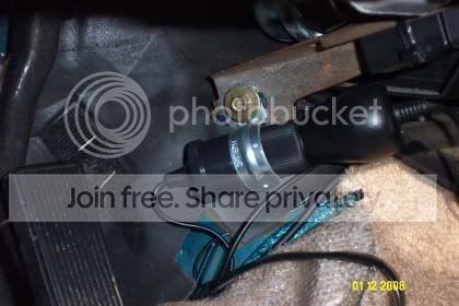

The cigar lighter receptacle is wired into a switched power circuit and held in

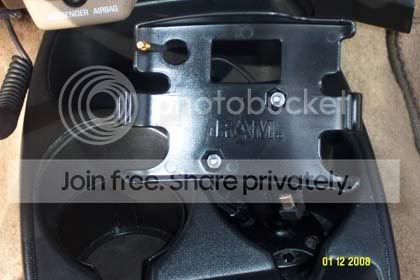

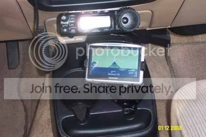

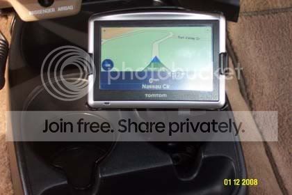

place with a 3/4" electrical clamp. The Ram XLS cradle was purchase so I could continue using my Ram mount. The cradle permits the TT to be installed
and removed easily, still holding it firmly in place.

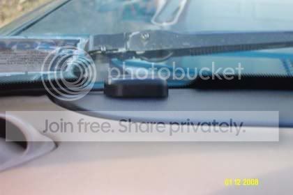

Purchaced a power adapter and antenna on eBay. The mcx connector is straight so it can fit through the cradle easily. Antenna insures the TT will
get a good signal sitting so low. Always receives 6-7 satellites.

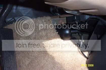

Power adapter has a right angle usb connector so it will not protrude far below the cradle.
