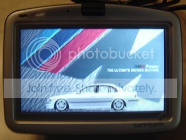

For my TomTom Go 510, its possible to change out the original TomTom Logo to anything you like. Just create your own image sized 480x272 and save it as a bmp file, then replace the file splashw.bmp on your SD card and waalaa cool personalized startup and shutdown image. :)
Here is my TomTom with my own modified startup and shutdown image.
Enjoy! and have fun Tweaking.
That's a great splash screen image, and thanks for showing me how to do it. I was wondering if you have other images to share with specify themes beside your BMW. :p
Thanks, I will be attaching a sticky with startup images for both the 3.5" and 4" screens shortly. Please stay tune.:D
